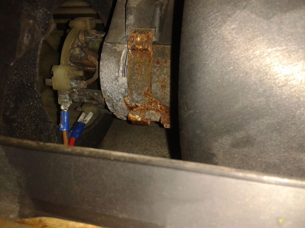

You could run a live and earth to the motor to check it, the connections are in this pic taken through the air flap
red is pos., brown is neg.(earth)
