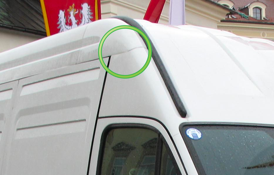

Do you mean this join here?
Posted Image
I managed to get behind a bit of the headlining there on the passenger side and there is a load of rust there and looks a bit damp, but I can't see any particular gaps on the outside. But if that is the place you had a leak I might take another look. If I have to dig out the sealant there then I'm going to have to repaint it as well... but if it stops it leaking then that will be worth it!

Yes that's it.
I used clear sealant - almost an invisible repair and no need to paint. At least not on a commercial vehicle, as yours is a camper you may be a bit more 'house proud'.
