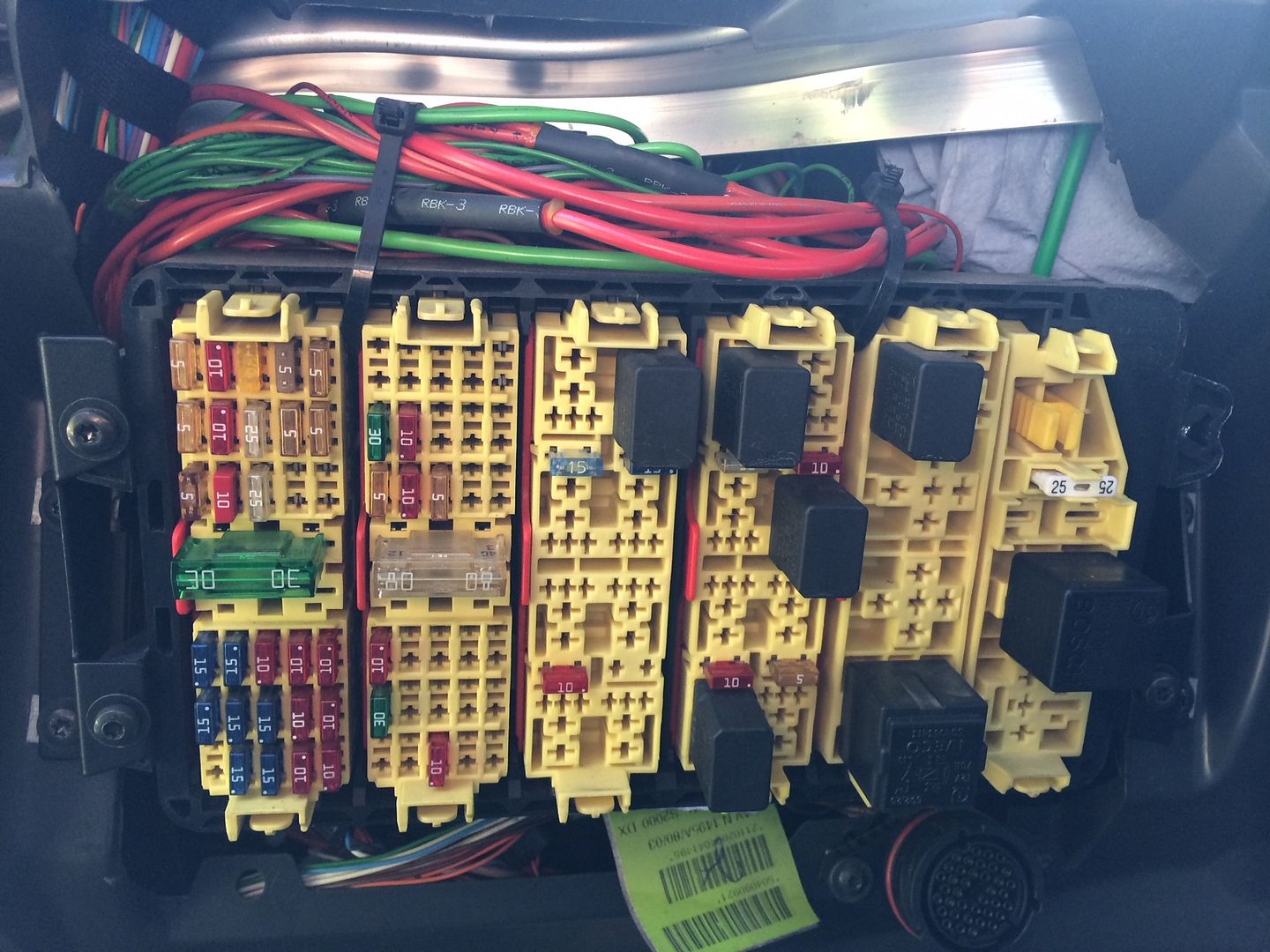

J_k
No Avatar
Tested it and it's not that.
The relay seems optional on mine.
And I don't have 1 fitted.
http://img.photobucket.com/albums/v653/joekont/ivecofusebox_zps5197de48.jpg
Meh.
On reading through ALL the fuse explanations, it seems there wasn't a fuse in the stalk feed for the foglights.
And they now work.
And there were fuses in places that for stuff that isn't even fitted to my van..
Foglights now work..
